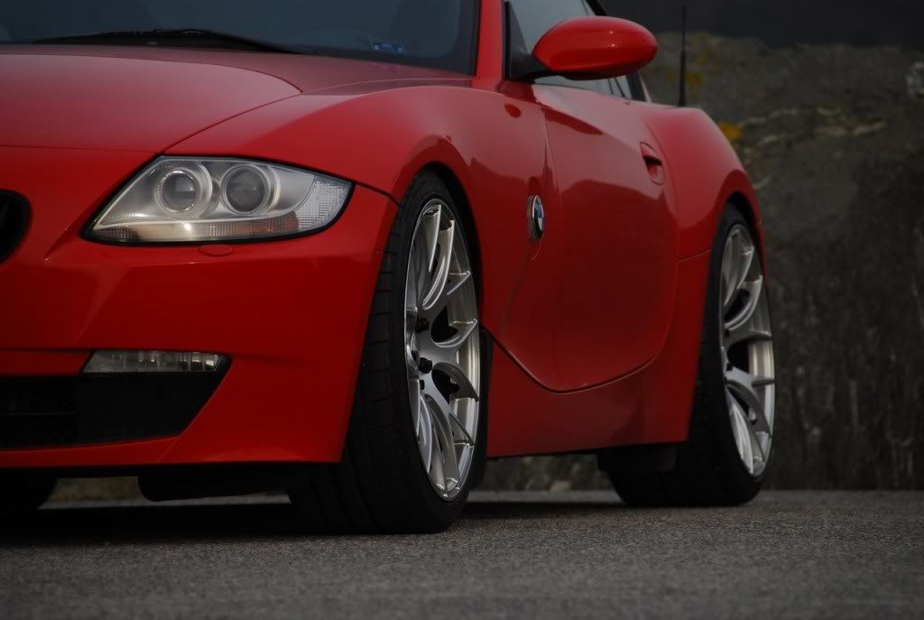

just as a FYI... on my VMR i have:
19x8.5inc et40 front and 19x9.5 et45 rear's.. it it lines up flush with the bodywork.
8,5x19 ET34 and 10x19 ET40. No rubbing in the rear. 235/35 and 265/30.
