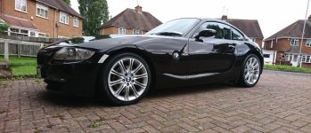

I’d suggest micro fibre pads are the way to go. If you’re new then the scholl 20 is a good all in one product. If you like to clean and polish regularly then go for a sealant then a nice carnuba way. If you clean once a month then maybe go with a ceramic coating,
I use as DAS6 pro with meguires mf pads.
I also use their cutting compound as they are designed to compliment each other.
Once cut, I use Megs ultimate polish, followed by Finish Kare 1000p sealant.
Each stage buffed with a fresh MF cloth.
I find the paint very difficult to correct so the polish helps by filling in minor swirls.
I bought all of my stuff from CLEAN MY CAR.

Car looks amazing. Are you pleased?
Yes. I'm pleased but there are some bonnet scratches I can't correct.
I'm a bit of a perfectionist so I'm never truly happy.
I detailed my Arteon with the same kit and procedure.
