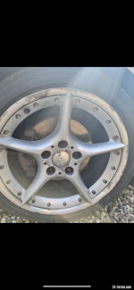

Just bought my E85 and they had never had the wheels refurbed they were a right mess as pictured I’m really happy with the new look and wheel just make sure to apply wheel sealant etc to see if it keeps them looking good
That's a great colour combo on those 108s :thumbsup:
