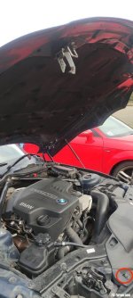

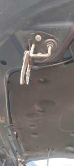

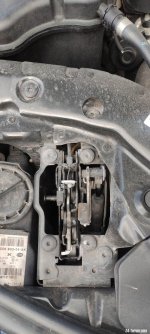

Can you adjust the bonnet /hood catches? The bonnet shuts fine and stays shut while driving. But one side feels slightly high so I can press down on it a few mm.
Quite a complex operation involving the hinges and catches..need access to TIS really to do the job or off line workshop manual..
There are four rubber bungs which you can adjust the height of by turning them clockwise or anticlockwise. It might help. You can see one in your photo I've highlighted it in the red circle, there is one on either side and then another one either side a bit higher up. I think you can just about see it on the bottom edge of your photo.

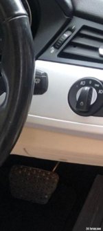

Little 'drawer' right of steering wheel just above where your right knee would normally be in dashboard. It's not big and easily missed as it is virtually useless! :wink:
Ah ! The cubby under the light switches. Yeah took me 3 years to find and never used since :lol:
Right below the rotary switch for the lights
Are you sure it’s actually shut properly? It’s best to press the bonnet down with a hand to either side & not just in the middle, it’s possible you only have one bonnet latch closed.
