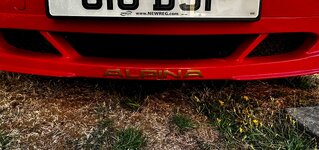

Grey OE grills back on and Gold Alpina deco on front splitter on Alpina RS no284 oh and a plate change.
