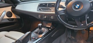

New member first post here. I've had my Z4 2.5Si for 10 months now, coming from a 986 Boxster. The lack of a decent phone connection has bothered me for the past months, so I took the plunge and fitted a BlueBus over the weekend. Seriously impressed with it!!
Been using the Z4 as a daily for the past few months. Not really a fan of screens in the Z4 but the lack of Google maps, roadworks and subsequent traffic around Norfolk and Suffolk means that my usual temporary solution isn't good enough anymore.
I usually balance my phone in the ashtray when I have to use it like this:
However this usually results with the phone ending up in the footwells.

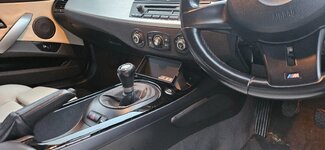

So I 3D printed an ashtray mount which can be removed when it isn't needed:
Haven't test driven it yet but if I end up liking it I'll sort out a charging solution.
You can get to heated seat buttons easily but to pop the roof down the mount has to be lifted out.
