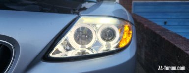

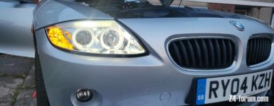

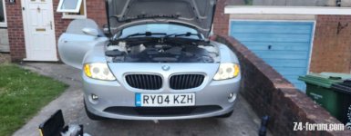

Bought a 2nd hand set of angel eye lights from umfaan, wiring and connectors heavily corroded.
Stripped it all away, re soldered and hard wired them in, connected up to the car further back, in the engine bay to avoid further corrosion.
