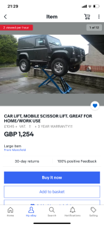

Hi Colb - do you have any details of your home lift?
Tempted with getting one....(might just be a boredom thing and trawling eBay too much!)
Something like this...

@saj77 My lift is the one you posted from ebay, supplied by BH Repairs in Mansfield, Notts. Best contact him direct, he has a facebook page and a website, you get a better price direct. Really good bit of kit, Chinese made but incredible quality. You will need a 32amp mains feed to run the hydraulic pump otherwise it will trip a 13amp circuit, initial start up of the pump will cause a 13amp circuit to trip. 32amp works fine, I have a separate circuit in the garage for 32Amp wired to a specific socket to plug into. Lifts both the Z3 and Z4 and the wifes Suzuki Alto. I can get the Z's quite high with the roof height I have, wheels will be waist high, tintop less.
It will come on a pallet on a lorry, they need a pallet truck to get it off the lorry and move it near to where you want it then its a matter of getting it off the pallet and setting it in place. For the Z's I needed scaffolding planks either side to drive the car on to clear the ramp, two thicknesses of planks either side. Planks sourced from a local wood recyling outlet. Planks were laid side by side to make a sufficiently wide runway for the wide tyres.

Best investment I have made, always managed with drive up floor ramps before but a lift makes everything more accessable and easy.

Thanks for the detailed reply. It does look a great piece of kit and I could make it work with my garage space.
The question (for me) is do I really need it or just too much time on my hands at the moment....

Oh go on! With the current situation we all need a 'lift'. :D
