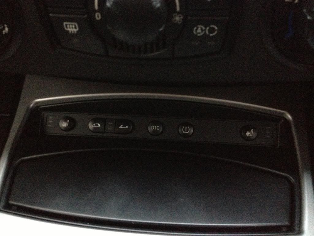

The Button second from the right --> ( ! ) what does this do??

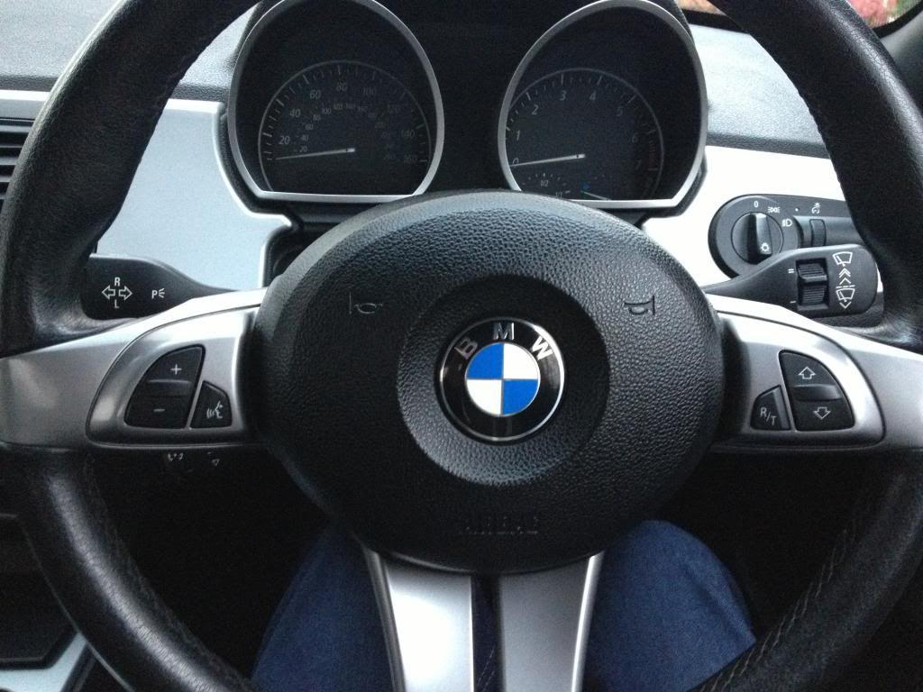

Also my steering wheel has radio controls but also phone controls, my car is not equipped with wireless phone option so seems strange to have these buttons? is it possible the previous owner retro fitted this wheel? also im guessing the adjustable setting on the wiper control stick affects the speed/ ratio of the window wipers? doesnt seem to have a noticeable change?

Question #1 The manual says: "The indicator lamp lights up red; in addition, an acoustic signal is sounded: Respond immediately by carefully reducing vehicle speed to under 50 mph / 80 km/h. Avoid hard brake applications and steering maneuvers."
Yea seen that in manual. doesn't make much sense to me :?
Why would a warning signal require a button??

Button is something to do with runflats I believe - mines on normal tyres so unsure what its use is exactly!
Steering wheel controls appear to be on all models even if the phone module was not bought as an option at time of manafacture,guess it saves having multiple steering wheel configurations, and their associated design/manufacturing costs
Speed control for the window wipers as you mention is actually the sensitivity of the auto rain activated mode, one click up on the stalk from its lowest position, use the wheel to adjust its sensitivity, sensor is on windscreen exterior side or rear view mirror.
Hope everything is correct, my fellow forum members will soon correct me if i'm wrong lol!

Second button is for resetting the tyre pressure monitor - not just for run flats. Having had a flat, can assure you both the monitoring and reset work :thumbsup:
And the phone buttons are standard on all cars equipped with a MFSW - just because they are there doesn't mean the car has ever had BT fitted.

Thanks guys, really aprreciate. Looked into the RFT's. i knew the car had them fitted but didnt realise there were pressure sensors, very handy!

They're not really pressure sensors, it's BMWs way of doing it - IIRC they measure rotational speed of the wheels and compare across axles. If it differs, the pressure sensors indicate an issue. Once the tyre is changed, you need to press and hold this button to reset the monitor...

You should re-set the tyre pressure sensor every time you put air in the tyres - hold it for 5 secs or so and the orange symbol lights up on the dash. Then drive off and it will go out when it has re-calibrated.

The tyre pressure sensor will also activate if your tracking is way out of whack.
Had this issue with mine and was only resolved once the tracking was done.
Remember you do need to check pressures manually as slow leaks not necessarily detected and you could have 4 empty runflats!

.....only if they all deflate at the same rate and the comparative rolling radius remains constant. Its the variation that triggers the system.

I haven't got runflats on but I presumed the system worked on normal tyres as well? Would the system be less or more sensitive to standard tyres?
It will work whatever tyres you have fitted.
I have non runflats and it activated with a loss of a couple of pounds due to a slow puncture.
Remember to stop straight away if it activates with non runflats of course.
Any advice would be great :D also anything a new Z owner should know which might not be obvious :D
cheers
Hi mate, i had this same issue when i got my Z4, i assumed that because the buttons where there that they all work.
Eventually i got around this by getting a local company to fit a Parrot CK3000 Evolution fitted in the roof of my glove box, with a extra bit of kit that sorts the phone buttons on the steering wheel. Its brilliant!!!
I have a iPhone 4s which has the Bluetooth always turned on. You get in the car, start the car, and with in 10seconds there’s a BEEP to confirm the phones paired automatically, BINGO, I don’t even have to get it out of my pocket. You can use SIRI, voice dialling, voice texting etc...
Best Mod iv ever had. Came to under £220 and he came to my work and did it in a couple of hours. JOB DONE! :thumbsup:

That looks about right Bing (cheers - yes thanks) - didn't realise I had old school / inferior DSC / DTC !
That's a good point about the Parrot kit too - I have the Parrot MKi9200 which does all this too (+screen & ipod/SD/USB control). I can confirm this makes these buttons very effective - you need a Parrot Unika cable / kit which to some is a DIY job - 'fraid I employed a pro
