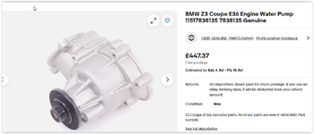

It was around £400, so not horrendous, although aftermarket E46 M3 water pumps are readily available for less than a quarter of that. Unfortunately, the spindle is too long and there is an additional feed that would need to be plugged.

This is the current part number that supersedes all previous numbers:
11517838135​
It’s unique to the Z4M and Z3M (with the S54).

There are two different iterations of water pump used in all of the S54 applications - one for the E46 and the other for the Z4M and Z3M. The former has a longer shaft and an extra hole in the body (which is what she said), the latter is a choad without the hole.
Interesting that the part seems Z3/E36, but I thought that you said that the spindle was wrong?
If you follow the realoem “Part 11517838135 was found on the following vehicles:” tree to its final conclusion, the E36 applications are E36/7 and E36/8 Z3M S54 roadster and coupe.
I paid 798 AUD including GST (levied at 10%). That is almost exactly the same as the price shown in your screenshot, assuming VAT is 20%.
