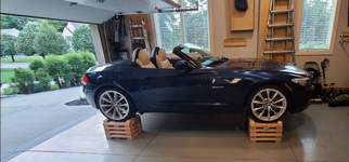

Like your ‘cribs’ :thumbsup:
Similar design here…
Nice! I like the height of yours with the larger dimensional lumber.
If I had access to a jack that went higher, I'd probably add another 3"-6". Just getting it up on these was a series of intermediate steps and a chunk of wood between the jack and the Zed.
Yes Ukrainian engineering concept…nothing like a bit of chunky timber :thumbsup:
