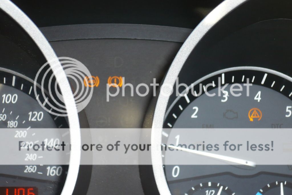

Warning lights '07 Z4 2.0
ABS, DSC and Handbrake warning lights. If you search the forum for these you will find endless possible causes and fixes. Best to get a cheap OBD2 code reader dongle via ebay and something like Torque Pro app to get the codes as a starter. Anything else is pure guesswork.
Sometimes disconnecting the battery will re-set it but odds are it will return if there is an underlying cause. Don't panic yet, it might just be a cheap sensor once you get the codes :thumbsup:
page 8 onwards gives some more info on the symbols and the doc has some details about the system http://www.bmwclub.lv/files/10_E85_Driver_Information.pdf
Not a great start to the year :( follow Ewazix's advice - hopefully its just a sensor thats triggered (the 2 ltrs are prone to engine management warning lights - I had one on my previous Zed that I'd clear and after about 500 miles it would pop up again, never did get to the bottom of it)
It can be many things but its most commonly the brake pressure sensor, a circa £100 part from a dealer and a very quick home fix, it literally unscrews in seconds. However, there are two of them and you need to have the codes read to find out which one it is, so if you don't have a scanner etc your at a garage anyway so you might as well let them fit it.
When these start to fail a quick key off/on usually resets things and you can keep using it for a while before it re-occurs. The fault then starts appearing more and more frequently till you eventually get to a point where it happens all the time.
Other things it can be include the ABS pump itself (about £250 to recon the pump) plus removal/re-fitting etc.
The first step is obviously having the codes read to find out what your dealing with
