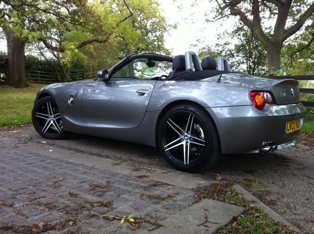

Here's my 2.5Se (standard springs) with 18inch alloys which were et35 fronts & et 40 rears but 8j /9j iirc ?
The arch gap if your car is standard will take them its the 8.5 et 35 fronts that need careful choice of tyres to avoid the possible minor rub on full compression / turn
Size up to 19s again will work its more about the width / offset & tyre choice
