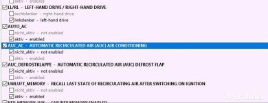

Hmm, also out of curiosity, is this responsible for the mixing flap by any chance? was set to not active, i later activated it 2 months ago and left it that way. just deactivated it right now to see if changing it was the cause of all of this.

I don’t think it is related.

So from what i can gather here, the Mixing motor % (From my 1st picture) should be adjusting depending on the temperature selection, correct?
For others following this thread, on ISTA, it is labelled as "blending flap"
