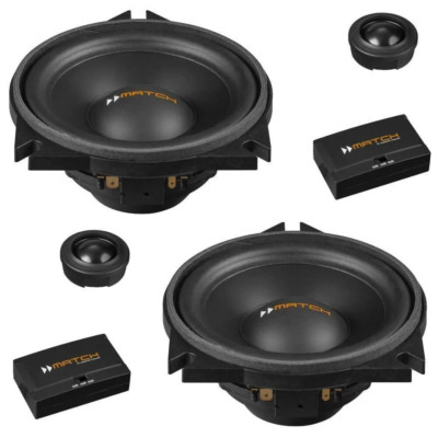

Swapped mine out for the match up ones. Big difference in sound quality.
I also added this plug & play amp
Same here,had the basic 6 speaker setup and it was atrocious-my l200 pickup puts it to shame! Replaced with the match speakers with tweeters but have to say still not impressed so considering the plug and play vibe amp

I installed Match and Hertz speakers as per my thread of August. Quite expensive at £400 all in but the sound quality achieved by the 10 speakers (four coaxial) using the existing head unit and amp was transformational.
