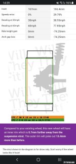

I can do custom made on any desire size so even 10.5" is possiblejamie_z4 said:The 437m is not 10.5j - it's 10j rear et40 as mentioned befofe
Pefry said:I can do custom made on any desire size so even 10.5" is possiblejamie_z4 said:The 437m is not 10.5j - it's 10j rear et40 as mentioned befofe
I can do any size (width) with standard offset. So in that case, for 10.5j the offset should be 33. The question is, any rubbing issues with 275/30/19?jamie_z4 said:Pefry said:I can do custom made on any desire size so even 10.5" is possiblejamie_z4 said:The 437m is not 10.5j - it's 10j rear et40 as mentioned befofe
I don't understand :? You said above you want standard offset of 437m wheels. They won't be standard if they are custom
Ok, it looks like that the only max option is to go for 10j without rubbing...jamie_z4 said:10j et40 which I said before would be close, so 13.4mm futher out will definatley rub.
