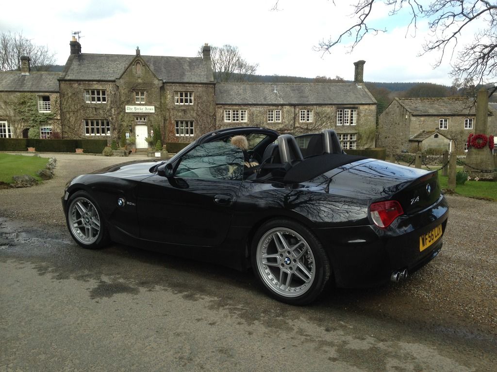

Some like more rubber & some don't , i would always up the non M sizes to 45 fronts & 40 rears but possibly 215 45 & 245 40 if running spacers or lowered
For a idea the rears on here are 245 40 18 on 8.5j et 40 / fronts 235 40 18 8.5 fronts :thumbsup:
