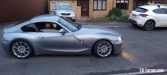

All sorted for Tobias this afternoon, Transport mode had set due to low battery condition. It wouldn't clear from the Body menu on my launch scanner because of a still low battery condition, however it was deleted from all modules successfully using the Launch scanner and upon doing so all systems were restored to normal, all fan speeds and HRW back to normal operation.
