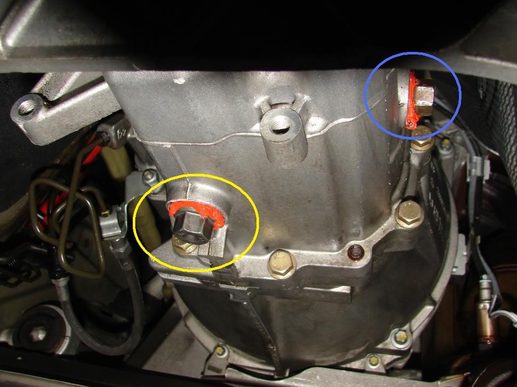

I've been searching near and far and cant find any how to for changing the fluid. I'm assuming the yellow circled plug is the drain and the blue is the fill plug, but how do you actually get the fluid into the box? I've heard of needing some kind of pump, and the car has to be level. Also, have any of you added any additives? Any advice is greatly appreciated! :driving:
One thing to do is to make sure the filler bolt comes off before you empty the oil out!
On my MR2 i used to use a length of 0.5" tubing and a funnel and fill from the top of the engine bay, once I'd poked the tube into the fill area. If you can get the car on ramps you may be able to fill direct, not sure though as I've not got on my hands and knees yet. Not sure about pumps but sure they'd work...
Yes, the lower one (in yellow) is the drain plug.
As leon says, make SURE you can loosen the fill plug before you start draining.
As for getting the new fluid in the transmission, you will need a pump or some other way to get it in... There are several types and makes.
No additives. Just straight fluid out of the bottle. Fill until you get fluid out of the fill hole.

Can someone advise on how much oil i'll need? I have a 2005 3.0.
Also...... while i'm at it, what about the differential? What oil should i use? and how much to order?

Just wanted to give my feedback on the transmission fluid change...
I read this forum as I had a clunky 1st-2nd gear change. decided to change the gearbox oil despite it being lifetime fluid.
I ordered the MTF-LT-2 fluid from the local dealer. £105!! ouch! only comes in 5litres. The gearbox uses 1.2l so i've got 3.8l if anyone wanted to buy it (im based in southend, essex).
Paid a local independent £30 to change it over for me.
It's def made a difference to the gear change. Maybe a 20% improvement.
Sometimes 1st doesn't want to slip in, and have to put it back neutral, lift the clutch, and then try again. normally goes in ok after that.
This doesn't happen often though. maybe 1 in 25 attempts.
2nd gear always clunks in. No problem at speed though, flies through smoothly.

Do the transmission and differential plugs have a washer? If so, are they re-usable or would they be replaced when the fluid is changed?
They have a seal in the plug
I replaced the whole plug as it was a couple of quid at bmw
