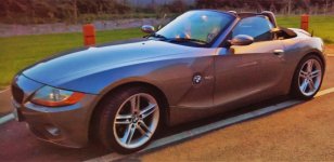

Hello Everyone,
New(ish) Z4 owner and loving it.... and also new to the forum so first post here, "brake" me in gently! Excuse the pun πŸ˜‚.
Bought the car aiming for track days and have the first one booked for Bedford Autodrome end of the month. Time for new fluid and pads, any recommendations and experiences more than welcome please???? I was also going to do the cold air ram mod i found on here.
Cheers, Paul
....and some pictures.

Hi and welcome, Paul. :thumbsup:
Your car looks great on those wheels - 224s I think.
