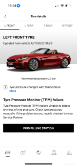

Damn & blast, so I received a Tyre Pressure Monitor (TPM) failure today, which hasn't cleared, even after a tyre pressure reset. I fitted my winter wheels at the beginning of November and have done a good 500 miles with no issue, left home to drive to Bristol, reading 2.3 bar of pressure in all wheels, stopped for fuel before getting to the motorway and after a few minutes of restarting journey got the TPM failure message as below.
Question, is this an issue with the module on the car or the sensors? If one sensor fails does it default to this error message? This would seem illogical as how would you know which wheel sensor had failed?
Anyone had a wheel sensor fail?

Took the car into Dick Lovett as requested by BMW assist and explained the issue, no one available to run a diagnostic, however they want the car for the whole day but can't give me a loan car! Service guy stated that if one sensor failed the whole system stops working as they are all linked (seems both strange and stupid as the only way to determine which sensor is faulty is to run a full diagnostic) or it could be the TPM module. As I have my winter wheels on, with non BMW sensors, elected not to waste a day and will swap wheels again at the weekend to prove which is faulty.
Good plan as no matter what is wrong, it will be due to third party products so no warranty, therefore £200 diagnostic fees etc etc
Another update - today off with the winters and back on the with the summer wheels, five miles later we have fully operational tyre pressure monitoring system, woohoo.
This is a system designed by a greedy unprincipled muppet, if a sensor goes down, the whole system goes down and there's no way of knowing which of the four sensors has failed until a BMW service centre analyses it, and what's the betting they only fail after your warranty runs out!
