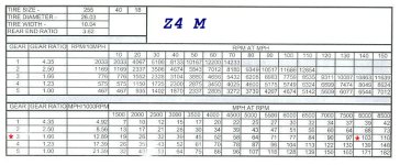

Have a look online for the ratios, I found them and with a little maths you can calculate it. You need your final drive ratio - got mine from RealOEM.

That's OK for a theoretical speed, but doesn't take into account wind resistance or the limiter. Coupe has a cd of 0.35 and a frontal area of almost 2m sq so in the higher gears it's arguable if it will never be achieved.
That said here's some theoretical I borrowed off t'internet
These speeds are for a z4 3.0 manual with the 3.07 (standard) ratio if you shift at 6k rpm. Multiply each speed by 7/6 if you want to find the 7k rpm speeds.

Has the si engine got longer gearing? I'm pretty sure mine did over 60 in second and felt like it would go faster than 150 in 5th?
Rob
3.0si manual final drive is 3.46. 60 is achievable in 2nd but you'll be way into the realms of the soft limiter, so I'm a standard car your better off shifting into 3rd at 6.5k ish which equated roughly to 55mph ish from memory....
