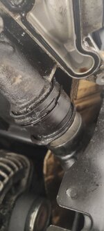

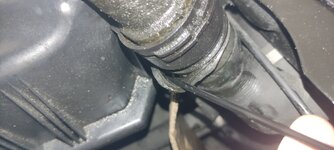

I'm replacing the gaskets on the oil filter housing and it's very oily.
I've noticed that the oil leaking on the pipe has made it soft and the edge has split around the metal band. I'd prefer to replace it than risk it.IMG_20251129_192653.jpg

You are likely to find the seals are flattened in the connectors. Change the whole thing. It’s not that expensive and would probably be a false economy not to
I got a replacement hose assembly today. Hopefully it's not stuck on the radiator like it is on the filter housing...
