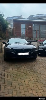

When I bought my car it had tinted headlights. I bought a headlight restoration kit because at first I thought they had been painted. It seems they were bought that way. They look fine but they are terrible at night. Vision is very poor bordering on dangerous. Can you upgrade the bulbs in these things, and if you can will it make much difference? I don't drive it much at night but would like to see when I do.

I would talk to BMW about this initially, I have never personally heard of or seen any Zed with tinted headlights, any BMW even so far as I can remember.
Why would anyone want them anyway???
Are they stained inside with something maybe ??
No tinted headlights were ever made by BMW for E89s in any model in any country…
Stock the headlights are pretty good..so it’s not a bulb issue…
I didn’t think they were standard. They have bmw stickers on them. Made by Hella. I’m guessing they are the original lights then? Here is a picture of the stickers.

OP, if you’re taking the route of replacing the lens, there’s a bloke in North Carolina that does all sorts of cool upgrades to the headlight units. Obviously it requires posting it abroad and be without use of the E89 for 3-4 weeks.
Blimey they are tinted.
You can get replacement clear lens, done it once to both lamps, bit of a pain.
Good time though to replace halos inside with leds.

The picture isn’t particularlyclear, but I had a problem with my lights. The eyeball lens of mine appeared to be misted - a bit like a cataract. I researched a place that would replace the lens element but couldn’t find anyone, so ended up buying two new Hella OEM headlights (good saving over the BMW parts price) and had them fitted. Headlights were perfect afterwards. Apparently the projector unit mirror that sits behind the bulb can become corroded over time and become much less reflective. The new lights and bulbs were night and day when fitted and then about 6 months ago on here, there was a post for a guy who can replace the lens and reflector. Will see if I can find it….
