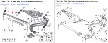

That's not a Z4 camber arm. Quite a few people swap with ones from the E46 M3 CSL which are adjustable. It looks like that is the case for your car. Whether they went for a genuine OEM part or a cheap autodoc knock off we'll probably never know.

That’s very interesting. I’d heard of plenty people adjusting the camber so assumed the standard one was adjustable but I guess not. Thank you.
The standard one is adjustable (cam bolt) but you don't have as much adjustment and it's harder to adjust than the E46.
Thanks, I’ve had a look at the drawings and makes a bit more sense now.
