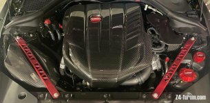

I have measurement from the eventuri, before and after
The diversion z4 has the first intake, but I don't know if they measured the difference
Noise wise there is not that much difference in my opinion, but my exhaust is a bit loud :D
I mainly added it for the carbon look, I'm guessing that's where most of the price difference goes to as well :).
