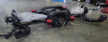

I also painted all the suspension arms, beadblasted all the aluminium parts etc, and that took far far more time than swapping out the bushings.
Getting the axle from underneath the car and removing all the bushings took me a long evening. Painting and doing up all the parts took me a week :lol:
Before (in all honesty, it was still in relative good nick if I see some of the more rusted UK parts due to the poor weather...)
After:
Mind you, if you take another back axle to do up, you're stuck with the condition of some parts like diff/driveshafts (obviously you can swap those out, but painting them etc takes time), and the brake rotor rear plates. You cant remove them without removing the rotor hub (which requires fitting new bearings), or you have to modify those plates.
