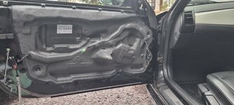

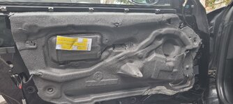

Still tho i had water ocassionly getting in, turned out to be the weather strip on the door, if it collects water on the strip by one of those drain holes like mine did then chances are its not sealing properly, I changed mine for a used one in good condition and I haven't had water in the car since.
Notice how someone replaced my membrane at some point in the cars life and just put it over the airbag
