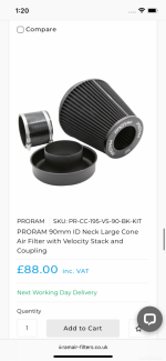

I’ve recently upgraded my stock air filter to a Cold air intake Cone filter (PRORAM 90mm Neck large cone air filter with velocity stack and coupling)

I don't understand how it can be a "cold air intake"? It seems to be drawing air from directly above and behind the radiator, surely the worst place to stick your intake? :?
+1 The standard setup takes air from behind the grill/in front of the radiator so will be taking colder air
I think filters like this are more for 'Max Power' bling than anything else
All they do is make more noise. Standard with a clean filter is almost always better in terms of performance and so on.
Thank you to everyone for the advice but I have decided to go back to the original filter for a few reasons, the main reason being that the car was not preforming as well as it used to and would not adjust the fuel to air ratio which lead to the car having a continuous engine warning lights appear on my dash no matter how many times I would clear it, it would not correct itself. also I couldn’t hear a massive difference in the noice the engine was making and the main reason I decided to swap my filter was for a cheaper option to get more sound out of the car. Not 100% certain if I tried every option to fix these issues but I’m not patient enough to keep playing around with it. I recommend sticking with the original paper filters.
