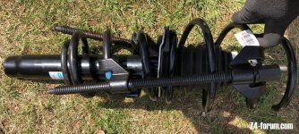

I use two compressors and a vice, whereas others have reported better results with three compressors (but then you need two pairs). [ref]pp1600[/ref] posted an alternative approach on “What have you done to your car today?” using a broken rear spring to provide symmetrical grip. The picture makes more sense.

I have the hook type compressors and yes, they don't compress enough to undo the bolt.. 'Zedebee' posted my solution in the second post using the hook compressors.. More secure than any spring compressor ive used due to the matching spring angles... and it cost nothing...
just stick a broken rear spring on the lower part of the strut...simples!
It also pulls the spring down square and allows the springs to be positioned easily on the spring pads.. which can also be a headache..
