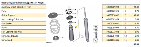

@B21 - Is the rear gasket you refer to "Number 7" in this diagram?

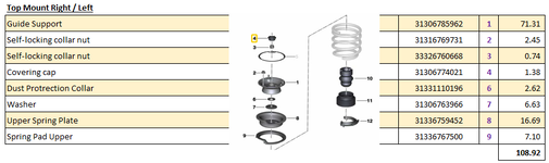

Thanks @B21 - And for the front I imagine "Number 5" then? Which (if so) I'll need to go find the part number for. (Not sure how I've missed that although it does seem to be greyed out!)
What suspension struts are you using on the front?
Perfect thanks @B21 will do.
