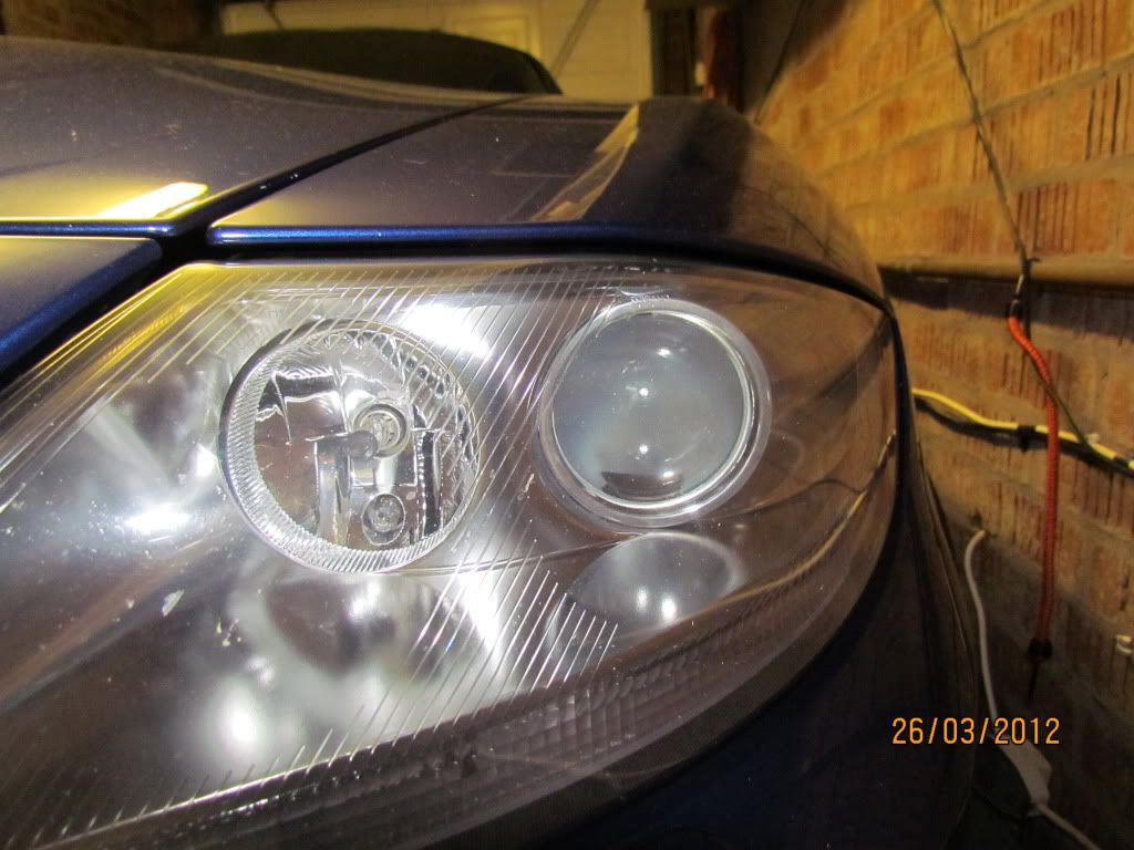

Is the bulb on the outside supposed to look fogged-up like this?
It's not fogged up, the lens is ribbed -
there is a thread on here where one forum member bought and fitted clear lens. This helped stop 'glare' and give a much clearer line of light, infact i ended up doing the same
