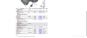

Yes, a manual 2.5 N52. I think I think perhaps the automatics may have an aluminum sump with steel bolts from what I have read with other models. Loctite is also advised
  • Screenshot 2024-05-30 at 07-41-37 RealOEM.com - Online BMW Parts Catalog.png
