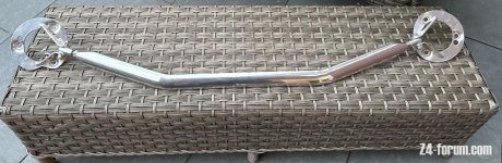

Does anyone know for certain whether a strut brace for a 35i/is will fit a 6 cylinder E89.
It definitely won’t fit an N20 as the engine sits higher, but does the 35i engine sit lower than the N52?
I never trial fitted the Wiechers strut brace on my 30i before I sold it, so trying to get clarity as don’t want to let a fellow forum member down with this :thumbsup:

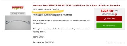

Depends which of the several versions it is…
Adjustable..fixed, aluminium with c/f…
See
https://www.dcperformance.co.uk/uprated/wiechers-sport-strut-brace/BMW/z4.html
Looks like most N54 versions fit N52s which makes sense as the engine casings and airbox are very similar
