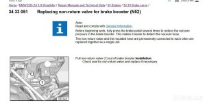

My question is, has anyone changed this pipe where it enters the servo. Does it just pull out or is some dismantling required. Also could this non return valve be malfunctioning such that revs increase and consequently air bleed back into the engine setting fault codes.
