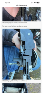

Im going to have another go in the morning, any tips? Also should the cable loop back on itself like in this picture.

Well I seem to have fixed it and then immediately made things worse.
So it seems that buying a cable from Amazon may not have been the best of idea the cable seems to be about 5-6mm too long.
I have moved the white ferrule out of its seat and packed out the other end by the latch with some rubber cable sleeve. That worked great. Put everything back together and go out to get my wheels aligned and got to the alignment place and can’t open the door from either the inside or outside handle now. Had to get out of the passengers door.
And I managed to break the little white clip that holds the door locked indicator on. So a great start.
Time to take a trip down to BMW and see if I can get a Bowden cable on order.
In the mean time any idea how to open the door (I assume the door card doesn’t come off with the door shut.)
Ferrule where it’s supposed to be
Ferrule moved to take up slack in cable
Rubber cable sleeve packing out the latch end (again probably not a bright idea and may be the cause of my problem)
I don’t think length matters (despite what the other half says) in this instance
But looking at this pic I don’t think you have the white bit in the right place- it needs to sit further up in the groove
You can see where the white plug should sit with the nipple bit protruding above the plastic
What matters is the correct placement of the ends of the cables, the sleeve placements and the routing of the cable

This is how I had it last night when nothing worked.
This morning I made some adjustments based off a few videos on YouTube where they pack out a stretched cable with washers and that seemed to work. I tested it multiple times as I was putting it together and was working well the only problem I had was if the door was locked and you pulled the door handle then my bodge/adjustment failed like it has now. The end of the cable I packed out with rubber sleeve slips into its locator hole and everything stops working. :(
Until I tried to open my door after a short drive (auto lock double pull to open) and I think my bodge with the rubber sleeve has slipped. I didn’t think the double pull from inside would cause the same problem. So maybe I should have tried the pen lid or washer tip.

This is the loopy loo on the cable I’m questioning. It seems odd that it is supposed to loop back on itself like this.
Dark photos taken last night
That's correct. Held in that clip on the carrier.
However, provided it's not catching on anything it isn't essential.
