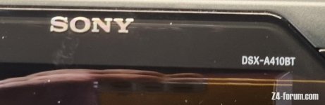

I've bought the below stereo and this wiring kit.
https://www.ebay.co.uk/itm/BMW-Z4-E85-E86-2002-2008-Car-Stereo-Radio-Fascia-ISO-Aerial-Fitting-Kit-CT24BM06-/251548256641?mkcid=16&mkevt=1&_trksid=p2349624.m46890.l6249&mkrid=710-127635-2958-0
I've just fitted the stereo and no sound. :headbang:
I have steering wheel controls (would like to use them) and the 10 speaker system. Please can someone tell me what I have done wrong?
I dont think you can just throw in a head unit on the 10 speaker system Dan due to it having a seperate amp, you have effectively fitted an amplified head unit into an amplified system, if you had the 6 speaker system its possible as that has no seperate amp.. changing the head unit on the 10 speaker set up is a lot more complex

Yeah, I'm realising that now. :headbang: :headbang:
