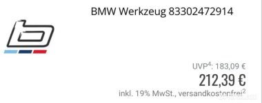

Robbi, These Stabilus struts are reasonable on Amazon -- so it makes sense to replace them while I'm in the mix. What is the special tool required and is it possible to fabricate it?
Edit: I've discovered the tool.. 83302472914 €178.48 at Baum.. -- a bit hefty for a single use tool. From your experience, are there other options to achieve removal and installation without this excess tool cost?
Seems like there'd be a generic clamp-like tool out there that would fit this niche or a ratcheting strap -- anyone out there use a pipe or strap method on an 800Nm strut?

In between I've bought the official tool, that makes live much easier. But of course, it's "a bit" (too) expensive for a single use.
Interestingly, this tool is absolutely necessary on E93/F33 convertibles, as there is much less space in the trunk to replace their 1.300 Nm struts.
Btw, I'll get a much higher price incl. VAT displayed from Baum24. Shipping and customs not included.
I did suffer the pain and purchased from Baum-24. It's currently in DHL customs/pre-shipment since Saturday before it jumps over the pond. It's probably stuck because it resembles a pipe based explosive device.
Once I'm done with it, I'll likely sell it to anyone else interested at a discount for my 4 strut wear and tear :lol: , without VAT or loan it for a small fee +shipping. Ebay or a local BMW indy may wish to pick one up.
