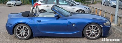

So I'm hoping one of you knowledgeable people can me please, as I've done a search on the forum and am getting completley confused as to what springs will / won't fit my car.
Its currently on lowered springs (fitted by previous owner), but due to a recent incident where it got stuck on the base for a removable post, I want it back to standard height. Its a 2006 3.0 si se (VIN checker indicates a May 2006)

Add some pics of you car [ref]Diamond Gaz[/ref],

I've been round the car this lunchtime, and the ground to bottom of the car clearances are 110mm at both front wheels and centre of the bumper, and then 115mm at one rear wheel and 125mm at the other rear wheel.
Yes, I believe its on lowered Eibech springs at the moment. A quick trawl on the springs for sale on Autodoc, throws these measurements up:

Those fronts (06248) are sports height. They say they are good for both auto and manual, with optional extras. Never been able to work out what those are tbh, but implies a bit more weight perhaps?
06247 is for Sports, manual box and no optional extras, so maybe not designed to hold quite as much weight.
Given you are concerned about ride height and that your current ride height doesn't look much below sports, then I would say the 06248 you have selected will be correct.
Bear in mind it'll sit a bit higher for a while until everything settles in.
Therefore, the rear 06231 that you have selected should be the proper match for those fronts.
To clarify then, 2x 06248 and 2x 06231
