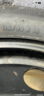

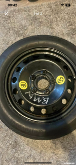

A ajs01 Member Nov 24, 2024 #1 Hi would a 115 / 90 / R16 BMW spare wheel be suitable for my 2004 z4 e85 3.0 ? Thanks in advance Attachments IMG_1141.png 583.9 KB · Views: 676
Rockhopper Senior member Mansfield Site Supporter Nov 24, 2024 #2 Don't think a 16" will fit, it need to be at least a 17".
Z Zedebee Veteran North Hampshire Nov 24, 2024 #3 It’s rather small. You need that profile on a 17” wheel ideally. Use www.willtheyfit.com to check compatibility.
Z Zedebee Veteran North Hampshire Nov 24, 2024 #4 And what [ref]Rockhopper[/ref] is alluding to, a 16” rim may not clear the 3.0 brake callipers.
Mr Tidy Moderator North West Surrey Staff member Site Supporter Nov 24, 2024 #6 I thought the pre-facelift 3 litre was OK with a 16" space-saver if it had standard front brakes? :? Anyway if you want a 17" one try to find one from an E46 330i or 330d as they had bigger front brakes than other E46s. It should be a 125/80 x 17.
