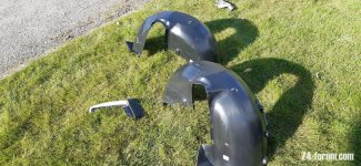

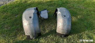

When travelling over the gritty roads round these parts the stones hitting the wheel arches sound quite loud.
I saw that some Campervan dudes use flashband to achieve some sound-deadening, so while I was repainting the rear calipers I decided to stick flashband to the wheel arch liners.
Used 10m × 10cm to do both arches. I was amazed at the plethora of different fixings that BMW used just to fit the liners.

Went for a drive and I do think it has made a slight difference. It is very subjective (roads, weather, placebo). You can obviously still hear noise but It has maybe reduced some of the higher frequency sound as the stones hit.
