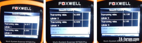

Playing with Foxwell reader.
My understanding is that the engine mang. is adjusting fuel to balance engine, based on variation in rotational speed.
Last two are far from others, but believe within limits.

just one correction, fuel, or rather mixture, is balanced to comply with emission standards, they don't care about engine running
the short and long term fuel trims (lambda additive, multiplicative values in case of bmw) show how long the injectors are spraying fuel
smooth running is more related to misfire detection, which inherently, can impact fuel trims - bad spark plug doesn't burn fuel, so the PCM takes away fuel, meaning negative fuel trims, etc.

Nice to know what normal values are.
