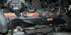

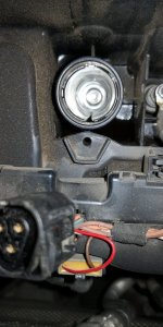

Cleaning the car the other day I noticed a small oil weep from the top of the engine on my 2009 3.0i sdrive.
It’s very slight and prob both worth doing anything about it at this stage unless it’s a simple tightening job.
There is some oil on top of the rocker cover joint but also a little higher up near the injector area. I can’t tell if it’s leaking near the top and running down or from the lower rocker cover area and being blown up. See pics. The pic of the top end isn’t focussed properly - need to look at the bolt head in the background.
So question is, is one of these a likely candidate. My hunch on past cars would be the rocker cover but is it the same with the e89? Would you tighten and rocker cover bolts a little as a first step? Have to invest in a torx socket!
Any thoughts appreciated.

Looking at that I'd guess rocker cover gasket, or worse, the actual rocker cover. Mine was cracked and leaking oil so needed replacing. Very common on the N54 unfortunately :thumbsdown:
Oops sorry, just re-read your post - 3.0i is N52 not N54, I don't think it's a problem on these engines?
This looks like the Valvetronic motor gasket to me. I'd replace it as it's very straight forward and will only cost you £20. Don't let your engine get get covered in oil and dirt.
I have made a posted some photos of that job here.

N52s (are) are prone to valve cover and valvetronic motor gasket leaks
I’d be wary of trying to “nip up” those bolts, they’re aluminium bolts going into a magnesium head so won’t take any over tightening :o
Rob

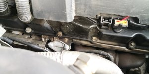

its not the rocker cover, you can clearly see the leak source is above the rocker cover/head joint. I am not familiar with the 3.0i but I presume that like the 23i it has the small electric motor in the middle of the rocker cover (drivers side) that changes the valve settings when you select sport mode.
Looking at the pictures I think your problem is around here.
Yes reading comments I suspect it could be the vanos pump gasket. Is it literally a couple of bolts on the pump to remove it and swap gasket or is anything else involved?
Thanks all

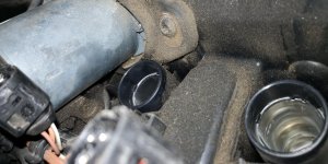

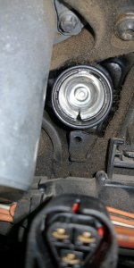

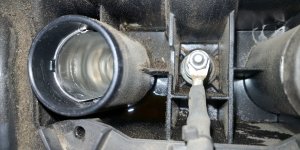

hi,
after removing the cover, the cause seems to be the valvetronic motor gasket
what I find strange (but I don't have a lot of experience) is, that around the second coil there's plenty of oil - inside none of the coil's had any
engine runs flawlessly, no codes etc.
is it the valvetronic actuator gasket?
thanks
yeah righ, nothing wrong with the rocket cover gasket :thumbsup:
