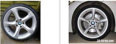

I only just noticed this, but if you like how 230s look you'd like 295s as well. They look identical, but 295s are 18s. :thumbsup:
I had a set on my Coupe on the first page of this thread, and although they don't come up that often I'm sure someone had a set for sale recently.
To me other than them having 5 spokes they don't look to much alike.
Perhaps I am looking at the wrong wheels.
