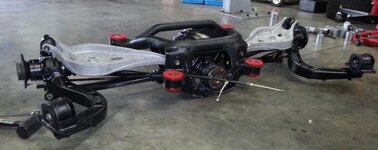

Yes, cleaned up by glass bead blasting and wire brush on an angle grinder (the trailing arms, due to the bearings not done in glass beading) and some painting.
Especially something like the aluminium control arms or the diff (cover) can get nice when glass beading:
And nice to have 100% new bushings.
The inside of the trailing arms need a real good coat. They are continiously under attack from debris coming from the tyres. 5 months after painting the paint was gone and it started to rust again. Not that that's technical a problem (thick iron cast arms), but not so clean. So partly cleaned/painted again and sealed with a few thick layers of tectyl clear. See how long that holds. (did some (cold) iron black oxide conversion too)
