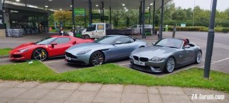

Thanks for all the replies guys.
I can safely say that my car with the new Eibach springs defiantly runs lower than shaunKC's car.
for me i really want to retain the very slightly lowered look.
Not sure what to do know.
Sean
