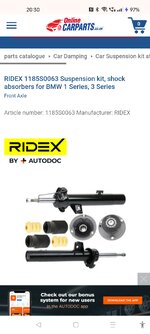

Im after some advice please. I have a 2003 E85 Roadster and the Vin Decoder says that it has M Sport suspension. I want to refurb the front shocks. Autodoc has a kit on sale for an E85 but do I need a special kit for the M Sport suspension or will any kit for the car work?

The only thing that’s different is the strut and the spring. All the rest is the same. I’m not sure Ridex is the best option though, most people go Bilstein B4 or Sachs.
Ridex are cheap for a reason
I’ve had experience of top mounts failing after low use and 18 months
Don’t scrimp pay a little more for a better known brand it’s a false economy otherwise
