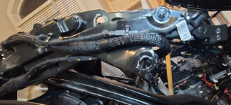

I got through the routing of the left side shell 1 & 2, still need to zip them down.
This is a larger radius than it was originally. It gives it a bit more working room when its closed (2nd pic)
So... less or good there? The other side which is still original is quite tight in the bend when closed. Right snug up to the joint.
Some hints:
Note that at point (1) there will be some movement in the hydruaulic harness as the hydraulic cylinder is pushed back and forth. Tensile stress on the two hydraulic lines must be avoided.
Point (2): push it down to be able to clip the hydraulic hoses into the 3rd mounting bracket below my red line.
Point (3): Don't extend the upper bow too much! After mounting back the rear roof shell there isn't enough free space for it. You run the risk of the cables kinking on the upper mounting bracket!
Every millimeter back and forth has its advantages and disadvantages.

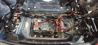

I figured out the problem with the top. missing a few things apparently...
Don't leave your car on the streets in the city...
This really makes sense why I need to jumpstart all of the time. :rofl:
