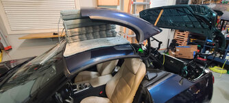

Finished installing the refurbed pump from Top Hydraulics and Shell 2 reinstalled. I'm going to run with the boot and interior trim off for a few to check for any issues. Filled with top tier petrol from Costco and ready to wash, shine and protect tomorrow. Topped off the new hydraulic pipes and pump with Febi ZH-M (to Max) and lined up the gaps to spec.
Hopefully that's closing out this thread. I've got some writing to do in the 'how to' -- adding to the existing knowledge and tricks.
I noticed that the left boot lid is pulling down a bit too far, so a little adjustment of the kinematics there is needed. but nice to be out on a rare sunny afternoon yesterday.
