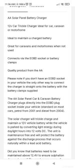

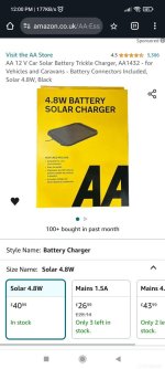

Would an AA solar charger that plugs into the OBD2 socket work ok?
